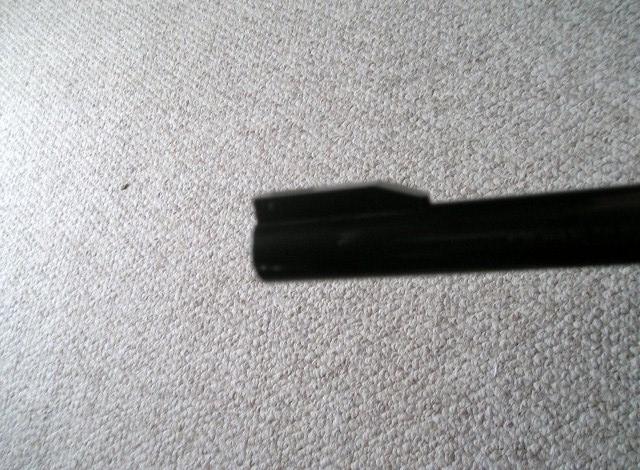

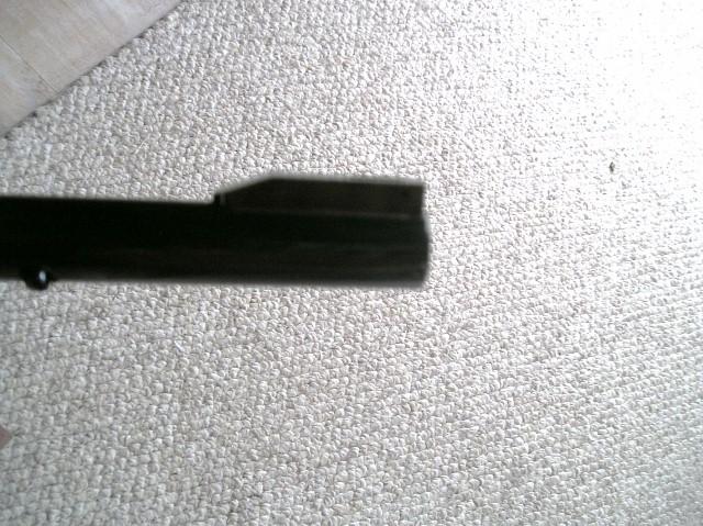

These are not good pics of the ramp but if you look close you can see a faint line along each side of the ramp where the solder flowed. I also just used a new blueing product to see how it works, Blue Wonder. I'll let you know if it comes out ok. Chris

I said in the previous post that I was trying a new blue product on my ramp. I am not sure of the results yet. I blued as per the instructions and after the required curing time for the sealer or developer as they call it,there was a film of rust which I wiped off and oiled. The parts are blued but I am not sure if it is any better than any other cold blue. I will see how it holds up. Chris
